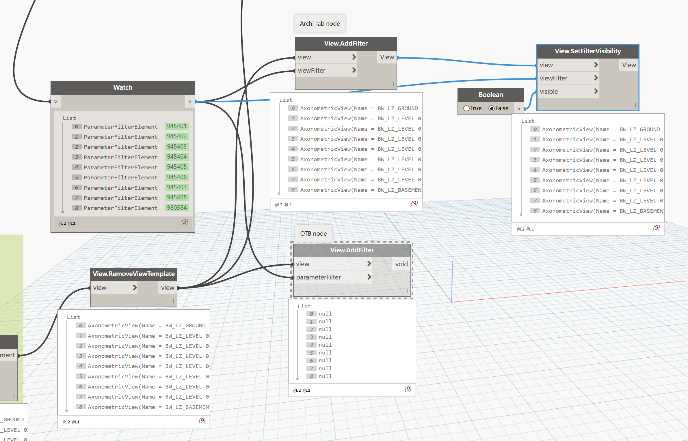

I am having trouble adding a view filter to views and turning the visibility off.
I have a list of view filters (in watch node below) and a list of views that I want to apply only one filter parameter to. ie parameter.filter[0] is applied to view[0]. parameter.filter[1] is applied to view[1] etc.
When I use the View.AddFilter node from the archi-lab Grimshaw package by @Konrad_K_Sobon it applies all the view filters to every view, where as I only want a single view filter added.
When I use the new OTB View.AddFilter it adds the single view filter as I would like but my issue with this node is its output is “void”, it would be great if this outputted the View as per the archi-lab node.

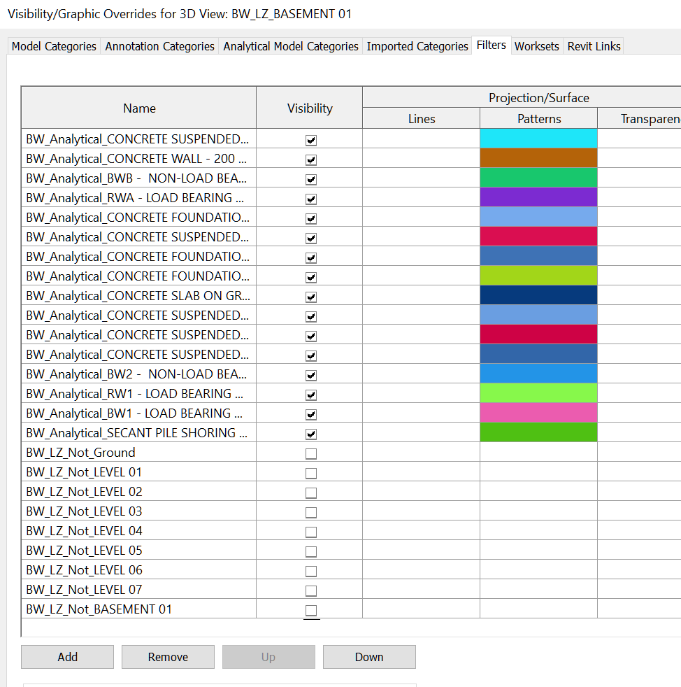

My next/similar issue is when I try to set the filter visibility using the View.SetFilterVisibility node from archi-lab package this node also adds all filters and turns them all off.
How can I just set the filter visibility for a single view filter for the one view?
