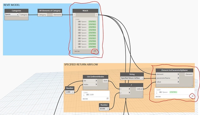

While I have your attention, I have another issue.
My testing model has TEN spaces with this parameter in it, but Dynamo is only pushing to one of them. Any thoughts here?
Nevermind, it was a LACING issue
