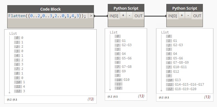

I have a list of numbers containing 0,1,2, and I created a function to create a number range for the list
where the list contains 0 - no number should exist
where the list contains 1 - the number goes up by 1
where the list contains 2 - the number goes up by 2
but for some reason, the script is not working.
Any one has an idea why?
I prefer to use Python. It allows you to create a range based on n values much easier.
out = [] n = 1 for i in IN[0]: if i == 1: out.append("G"+str(n)) n = n+1 elif i == 2: out.append("G"+str(n)+"-G"+str(n+1)) n = n+2 else: out.append("") OUT = out
out = [] n = 1 for i in IN[0]: if i == 0: out.append("") else: strings = [] for nums in range(n,n+i): strings.append("G"+str(nums)) out.append("-".join(strings)) n = n+i OUT = out
@michalz I think it’s related to this bug:
there is a workaround provided at the end of the thread.
