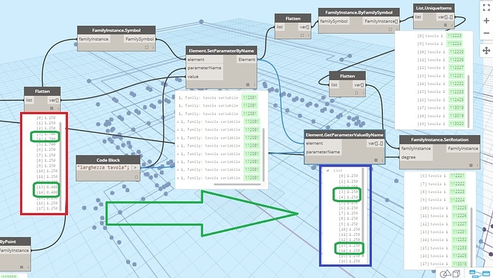

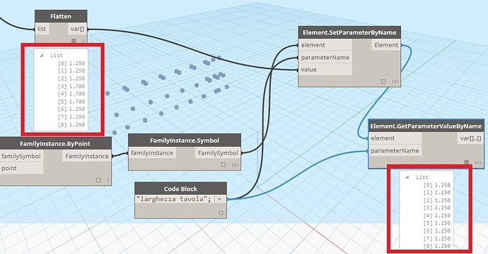

I enter every family a distance (red rectangle)
result - blue rectangle
the distances are all the same ?? not included are the distances of the red rectangle
It takes only the first (1.25) ??
some help?
Thank you
Hi @alex_volt,
Try changing “Lacing to Longest” at “Element.SetParameter” node.
Thanks Kulkul … but does not work
Could you drop your files here?
