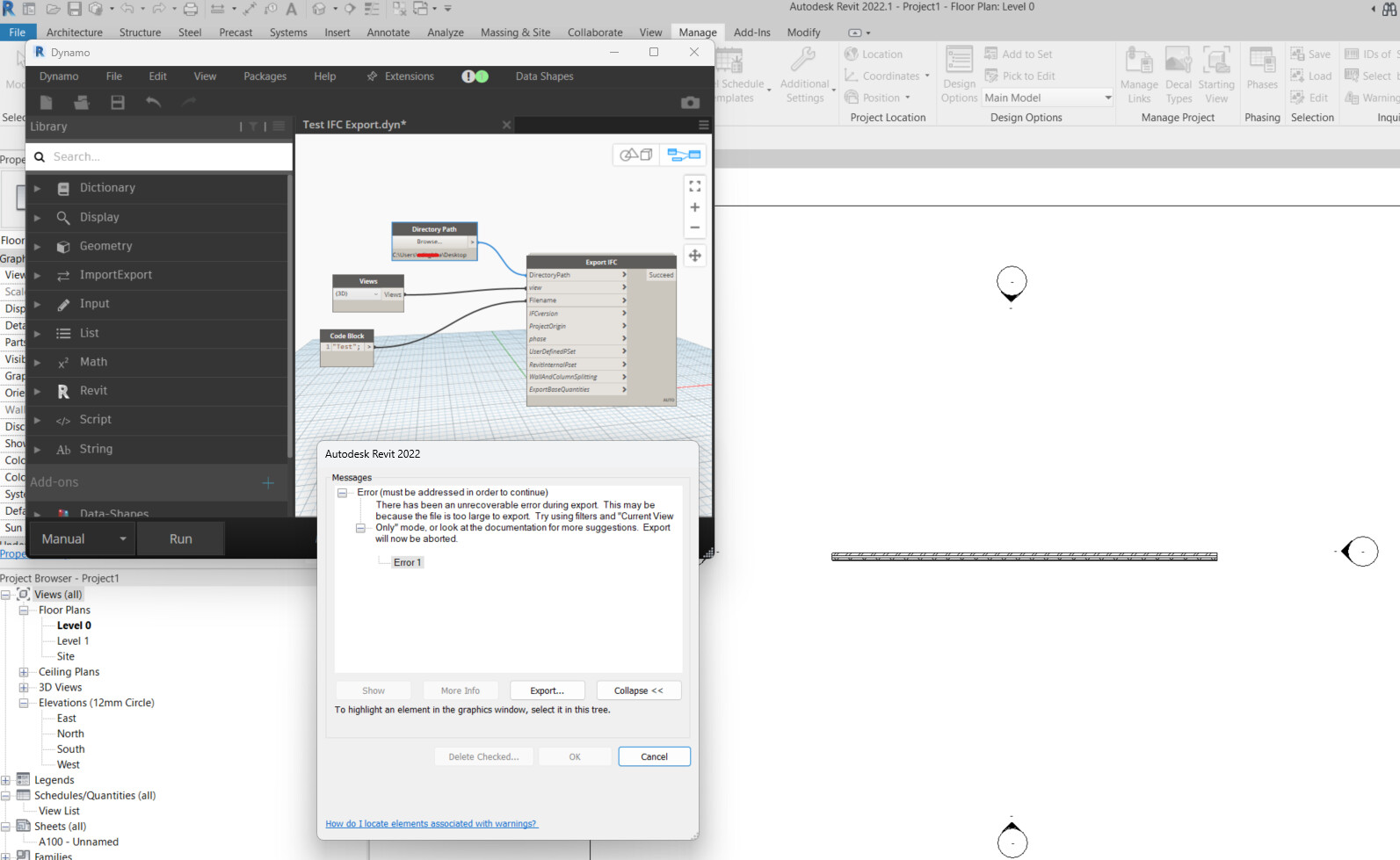

First post here on the forum, since I could not find anyone else facing a similar problem. I set up a pretty complicated script to automate IFC exports for my company primarily using the Export IFC node from the Genius Loci package. It worked like a charm for a few times, before randomly and suddenly giving me the following error: “Error 1: There has been an unrecoverable error during export. This may be because the file is too large to export. Try using filters and “Current View Only” mode, or look at the documentation for more suggestions. Export will now be aborted.”
After getting this error once, it is as if the script breaks completely and all subsequent exports still fail in the same way. I even tried to simplify the script and model but still getting the same error (as in the screenshot)

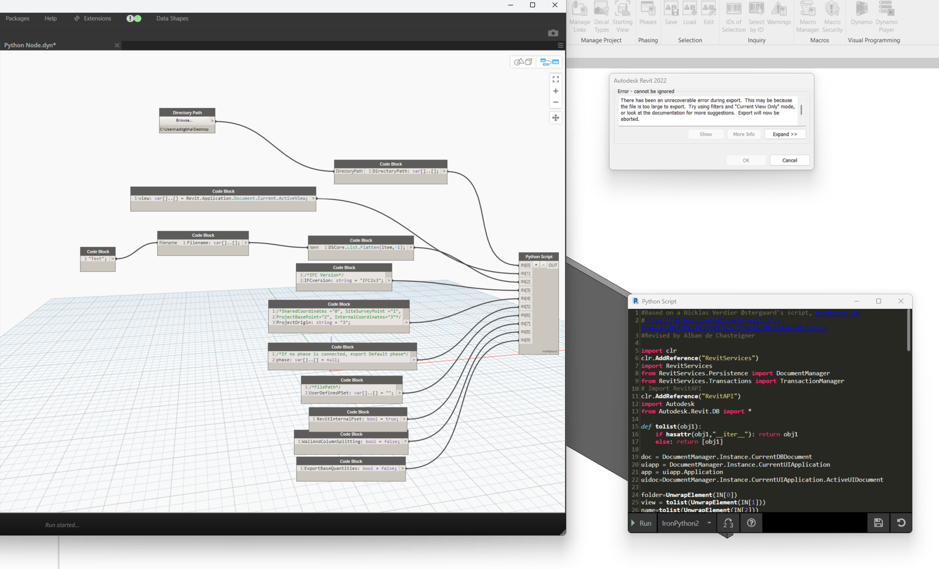

If the Export IFC node is just a python script, you could try running just the python node in place of the custom node and watch for any errors. A custom node won’t surface any of the errors occurring within the node itself, but if the python code is failing on something specific you might be able to get a little more context as to what’s happening.
Hey Nick. Thank you for the prompt response. Highly unlikely it is a problem with the Revit file. The file in the screenshot (and what I am testing with now) only has a generic wall, and nothing else, because I wanted to test with the simplest possible geometry.
I tried to run the Python script itself keeping all the inputs the same, but seems like I am still getting the same error. It seems that the script itself goes through with the inputs successfully without any errors, then it is Revit that gives the error message, and once I click cancel (since it is the only option available), the script completes it’s run and I get a “Success” message if I put a Watch node in the end of the script.
