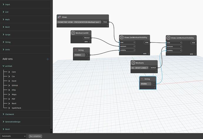

I’m trying to do a walk-through of Worksets.
Intent of the flow here is to turn all worksets off in a view, and then turn on a single one using a picklist of the worksets in the project, so I can what workset geometry is on, and then if necessary, select and place on the correct workset for the object.
When I run the first time, it turns all worksets off (Hidden). When I select an individual workset from the picklist, it turns it on.
But then when I select another workset, it turns that on but the previous one also stays on.
And on on.
I just end up with a graph that turns all off, then turns them on one by one.
What am I not understanding here in how Dynamo works…?
Hello @JohnSmithUN5MX,
On a rerun, dynamo will only execute nodes if one of the inputs of the node has changed.
As you set another workset with the dropdown, your second setVisibility node will execute again. But the first setVisibility node will not.
Run the graph with dynamo player. On the player the behavior is different, the full graph will run everytime. It’s the same behavior as you get with dynamo if you close the graph and reopen after a run.

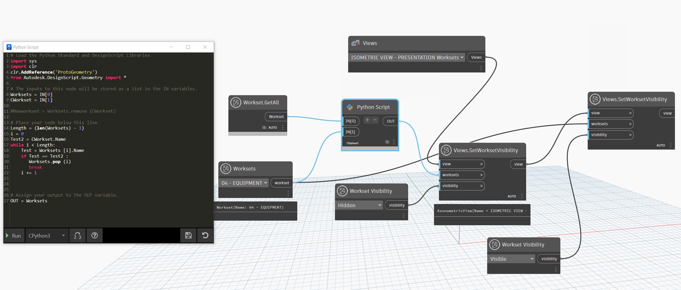

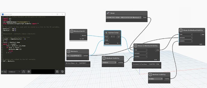

Knowing what to look for, I’ve revised the graph to have the list of worksets sorted through in a Python node,with the one I have selected removed from the list, and then that list of worksets (less 1) set to Hidden.
The selected Workset, is itself set to be Visible.
My first Python routine in my first Dynamo script :slight_smile:
