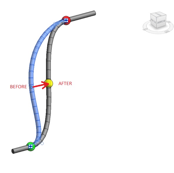

I would like to translate only the middle point (nurbscurve) of a flexpipe to a known x,y,z coordinates (yellow ball), but I don’t know which node I should use.

Hello. I need to move a point of the current pipeline, not create a new pipeline. Thanks
Hello. I think this creates a new pipe, and deletes the previous pipe. Thanks
FlexPipe.Points is a list of points, and it’s possible to set them:
So it should be possible to modify a pipe’s points without deleting and recreating, at least the api lets you do it. I don’t know if a package or node exists for this, I’m just saying from Revit’s side it’s possible.
Hi. May i know the package details for this particular node. FlexPipe.Points
yeah sure, guess it was openmep package and can be installed from here…Releases · chuongmep/OpenMEP · GitHub
thank u very much. It worked for me
