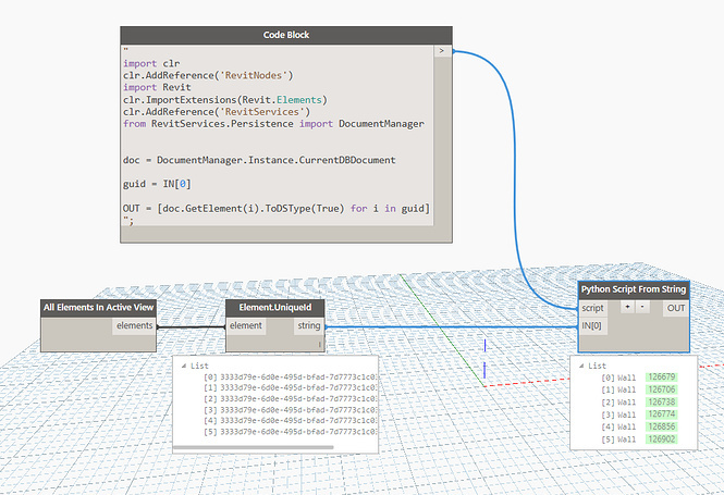

but then i use this it works ?

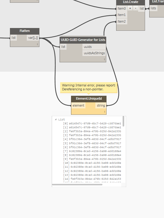

the issue is then what about the ones from before, what where they ?

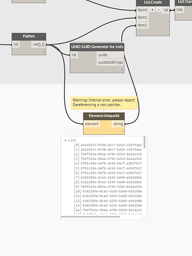

the information is to partial to be able to do more than assume… but it looks like there are things comming out of that flatten list that are not revit elements.

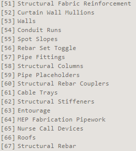

this is what gets in
okay those are categories …
yes and then i get all og the elements and there types an instances and work with them
what happens if you try just this and and none of the rest on your document :
That works except i do not get the furniture’s
ok that means that the problem comes from another part of your script… you have some redundant parts and custom nodes that I don’t have so I can’t really run it… but my honest opinion is that you should try and rebuilt it and simplify it. Getting the elements from guids is not the problem anymore.
