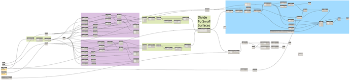

Here you go
Thank you Mohammad Nawar,
I used the same script and modified it according to my requirements,
Here is what i made of it.
Please do let me know if it can be made more simpler and could be integrated with Revit as an addin

Here are the files.
i have also used the adaptive family to get the exact tile sizes, purpose being to know the resue of tiles

The dynamo script i shared , works on first picking the surface and then picking the start point of the tile on the surface. With the Tile size mentioned.
