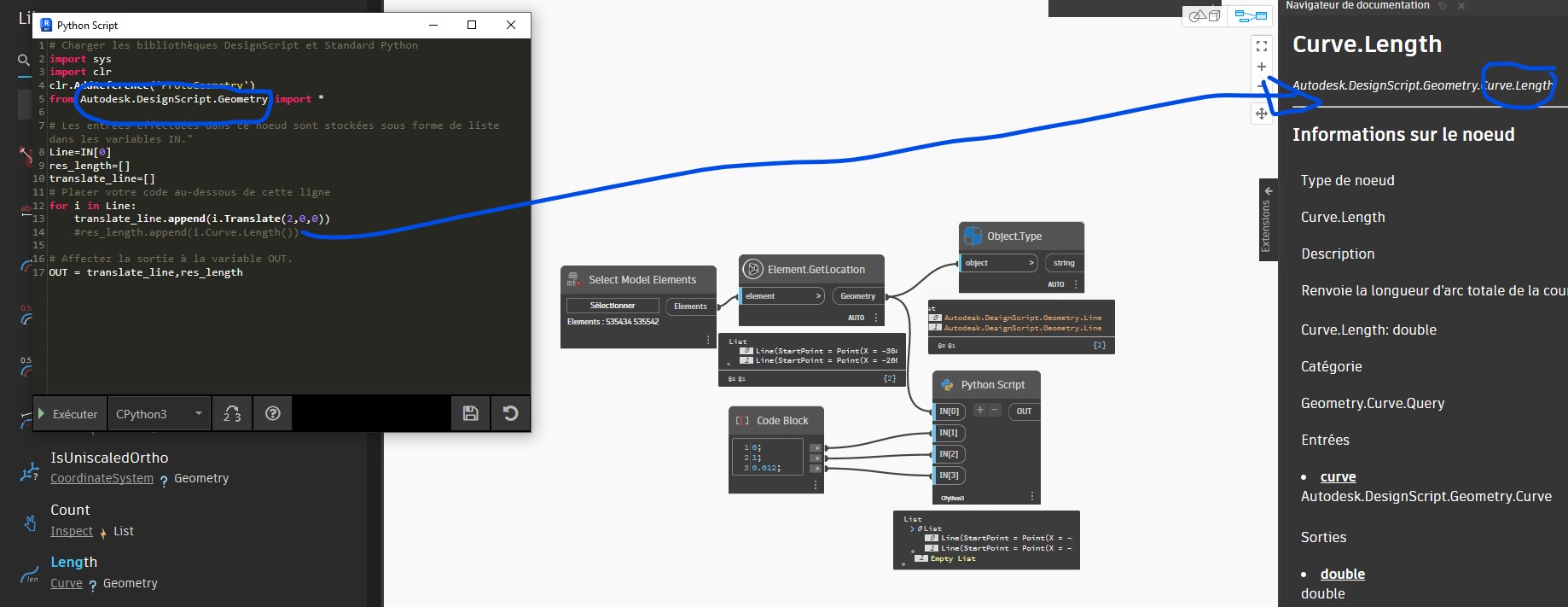

I found, but I’m not sure of ‘‘my analysis’’
Capture d’écran 2023-01-06 211636
for i in Line:
    translate_line.append(i.Translate(2,0,0))
    res_length.append(i.Length)
cordially
christian.stan
Translate() is an ‘inheritance’ method (from geometry object)
Length is a ‘get’ property (from curve object)
you can find some info here
an inheritance graph (for Geometry)
