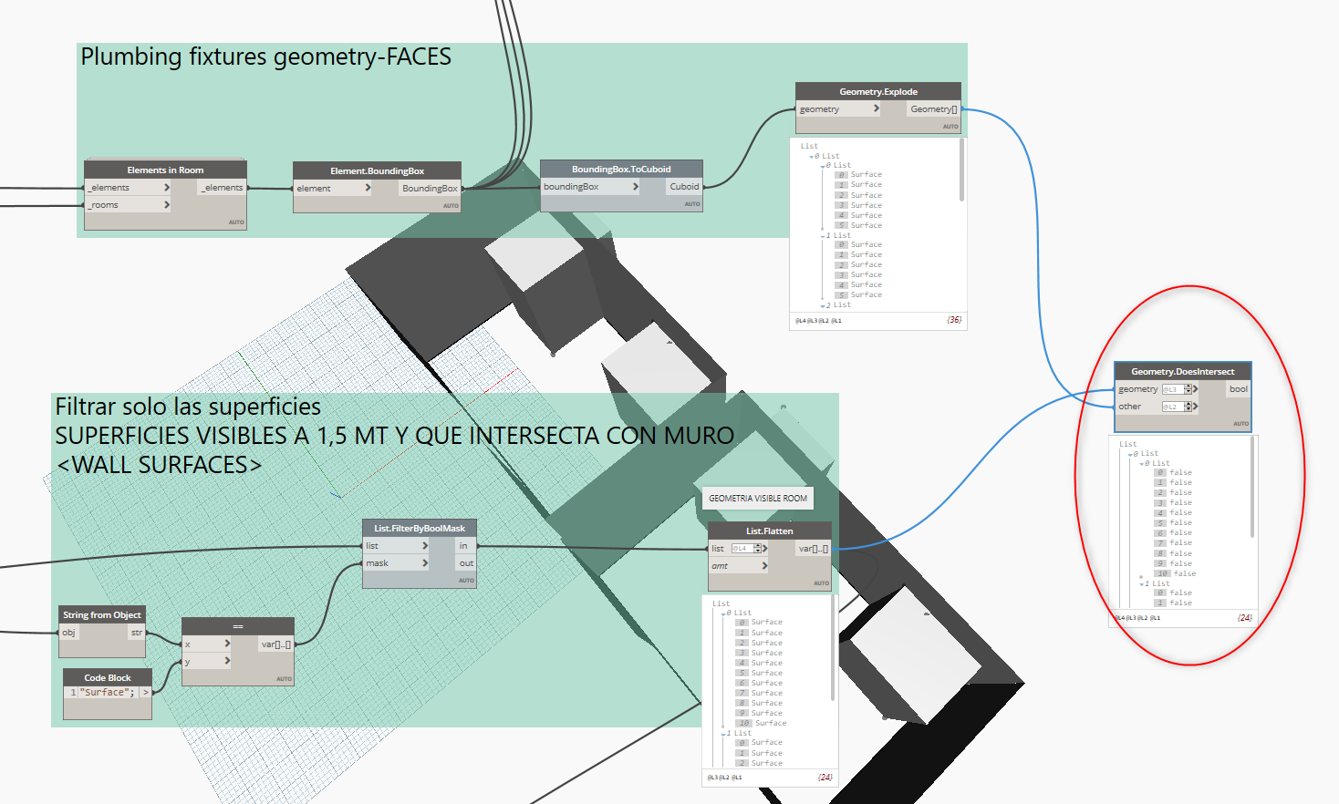

Hi, I have a problem with the geometry.does intersect node as I try to intersect two surfaces and it throws me all null.
I obtained the geometry of the sanitary fixtures and the geometry of the walls, so I need to obtain the walls that intersect with sanitary fixtures, to obtain their area
I have tried with different combinations such as changing the level or changing the lacing to longest or cross product but it does not work
20200621 Imper hum.dyn (125.4 KB)
You’ll have to use Corss-Product lacing to ensure that everything is being checked. I’d recommend intersecting solids first (less computations) and then individual surfaces if necessary.
Ok , this is the final combination
