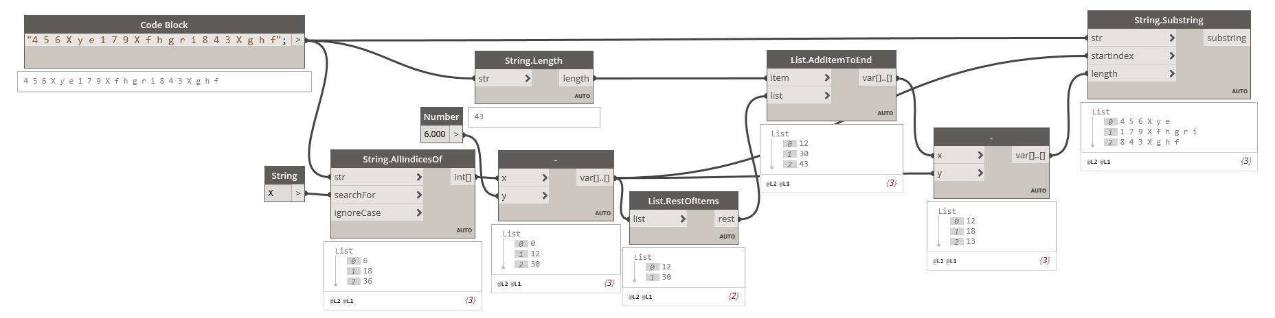

Did you try the String.Split OOTB node with the separator as “X”?
Hi @MarcinLas
That’s bulls eye.
Hahahaha :smiley::laughing::laughing: I like the word bulls eye :laughing:
ForMarcinLas.dyn (2.4 KB)
Please mark the post as solved.
Sure it’s possible
subString.dyn (16.8 KB)
