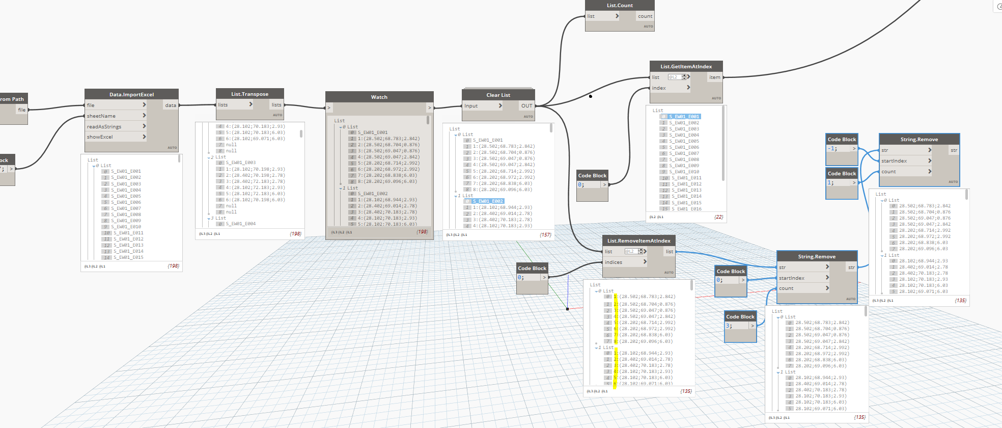

Can someone help me to seperate the numbers marked in yellow into a new list?

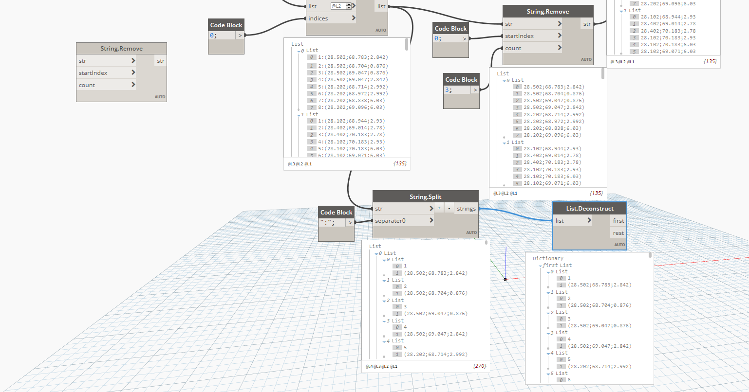

String.Substring node.
Or string.Split with a split character of ‘:(‘ which will give you the prefix number and the following decimals as a list. Add a List.Deconstruct with proper lacing and you should be all set.
Lacing is off… gets the first item, and passes the rest. Same as a list.transpose into a list.first and a list.drop.
