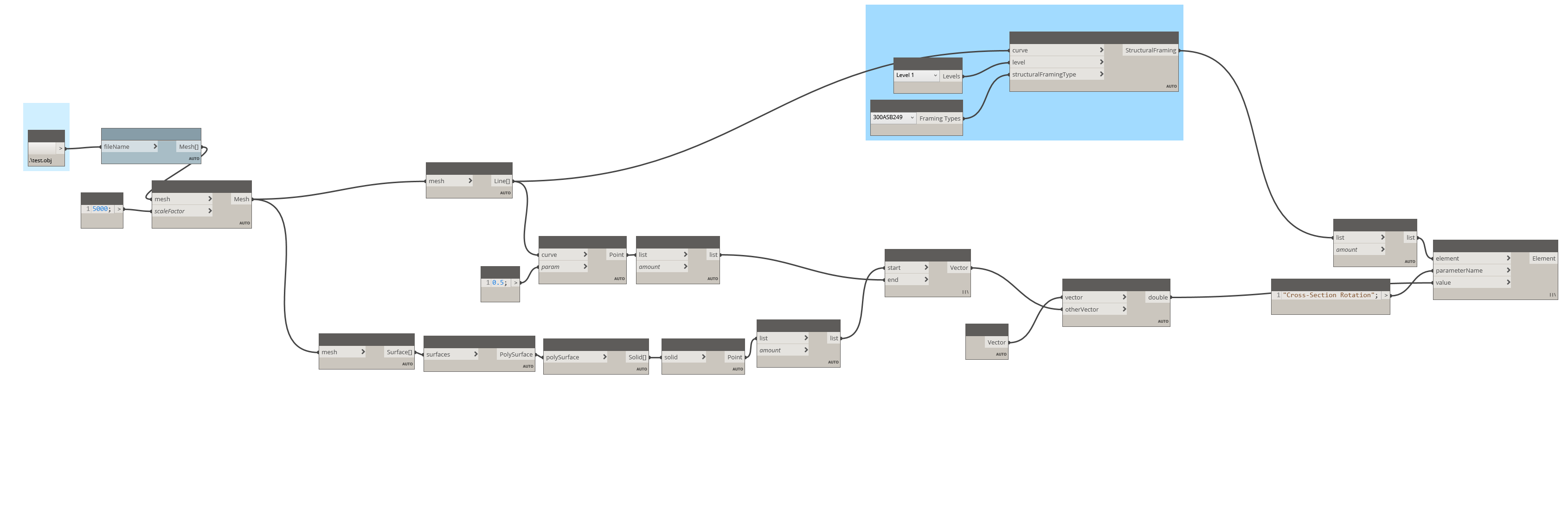

How to orient automatically a beam to z to be tangent to mesh’s curves ? I have tried several options using vector and normals but have not been able to get the beam to orient to the curve instead of being straight to reference level.

My complete script currently :slight_smile:
And my problem in image (beams are not oriented from origin but from level)
Thx for your help
Hello
Take a solid centroid
get a vectors between centerlines and centroid
get angle between Zaxis and Vectors
set
done
Perfect that’s works correctly with some correction. I’ve used curve.NormalAtParameter node particularly.
