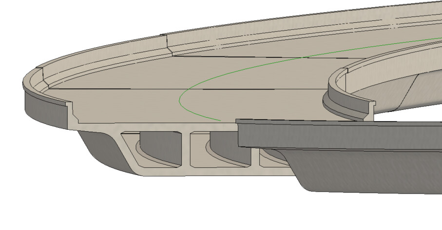

I am trying to place a structural framing family on a curve, the curve is not level in the Z dimension, the problem is I cannot get them to place straight horizontally, by setting the rotation,
I have even set up a rotation for the two profiles I used to make the beam
I just can’t get the rotation correct there is always a small error between the beams,
I have tried using the vector of the curve to the Z axis for the start and end and set the rotations there, no matter what I try there is always an error in the rotation, would anyone have an idea how I would keep these section level horizontally ?
