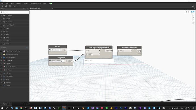

Structural Framing on a Particular level
How Can we Select Structural Framing on a Particular level using Dynamo
Hi @jazzsharma200,
Even simpler, the SelectByCateOrTypeAndLevel node of the Genius Loci package allows you to filter Structural Framings by level.
It’s Selecting all the Beams in the Project.
Not Working.
show your graph…what is the error you are getting?
@Alban_de_Chasteigner graph working fine for me…
That’s pretty much how I’d do it, but I’d suggest adding a split function to isolate the level name, then it can be compared to an actual levels’ name as nominated by the user.
Beams by level.dyn (18.4 KB)
This is not the right node. Use instead the SelectByCateOrTypeAndLevel node. Copy and paste the node name in the library search engine.
