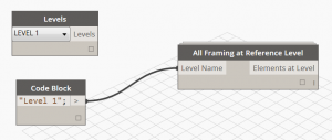

Framing is weird because it utilizes reference level. Here is a method I managed to whip together.
Or you can just download Rhythm and use this node. It takes a string or Level Element
Wow that simple! Thanks so much!

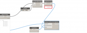

By any chance you can answer this to? I have a string from array with a value i’m using in to set a parameter, but the value is in a parentheses (See picture)
Is it possible to take away the parentheses so i only get the text?
Use String From Object instead.
Thanks guys!
