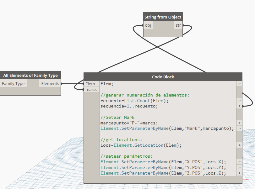

I’m trying to convert a list of numbers to a list of strings, instead of using a node (StringFromObject) I would like to call the same function in DesignScript, to keep everything in a single code block.
The more similar thing I have found is the “ToString()” command, but it acts like the “StringFromArray” node, returing a string with its curly brackets etc.
Is there a way to avoid this ugly lacing I have done in the attached image?
thank you all!
Try this:
Put the number in parentheses and then use a + and open then close quotes.
(Numbers)+“”
In your case
marcs = (1…List.Count(Elem))+“”
Thank you Jacob, it works!
I didn’t know this feature existed.
Is it documented anywhere?
Thank you again
Not sure. I read it in the forum once I think from a post @Kulkul made.
