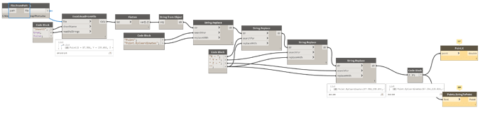

Is there a way to use a string as design code? I have a string imported from excel which was then formatted as design script, but cant seem to get it to work. The picture attached should make it obvious what I’m trying to do.
I think your problem may actually have a simpler solution. If you isolate each of the coordinates, you can provide these directly to the standard Point.ByCoordinates node. See below:
str to pt.dyn (25.3 KB)
There are more elegant ways to parse strings if you use Python, but this OOTB solution works as well.

I guess the point of this exercise was just to see if it was possible to run DS code from some formatted strings out of curiosity.
I had to place some elements based on points I extracted from another project and I was playing around with ways to convert the exported points for my family placement. I ended up creating a custom node that split the string apart and created points using OOTB nodes.
@cgartland Thanks for the suggestion. I did something similar to your example, but yours is much cleaner.

probably the easiest way to do this that I can think of is to have an extension that creates codeblocks and sets their code property to your string.

here is 2 alternative with python script
code_1
import re
def gener_pts(str):
	lst_ = str.split(",")
	for x in lst_:
		ptx = re.findall("[\d.]", x)
		yield ("".join(ptx))
data_str = IN[0]
if not isinstance(data_str, list):
	data_str = [data_str]
out = []
for x in data_str:
	ptx_lst = gener_pts(x)
	ptx_X = float(ptx_lst.next())
	ptx_Y = float(ptx_lst.next())
	ptx_Z = float(ptx_lst.next())
	pts = Point.ByCoordinates(ptx_X,ptx_Y,ptx_Z)
	out.append(pts)
OUT = out
code_2
import re
data_str = IN[0]
out = []
for x in data_str:
	_temp = re.sub ("[XYZ= Point]", "",x )
	out.append( eval("Point.ByCoordinates" + _temp))
OUT = out
