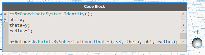

I have created a Point with Point.BySphericalCoordinates in DesignScript. To compare it I have also created a Point with the node “Point.BySphericalCoordinates”. The node seems to work, but my DesignScript Code creates a Point not at the right place. What is wrong with my code?Point.BySphericalCoordinates.dyn (11.1 KB)

ty Vikram,
it is wrong in the Dynamo Language guide. There a lot out of date…
