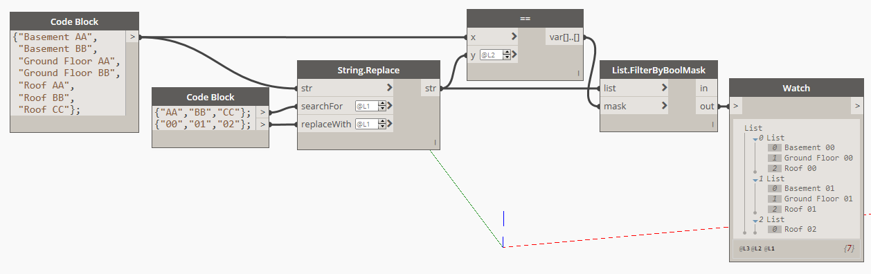

I can’t figure out how to use String.Replace with lists.
I want to replace strings “AA” with “00”, “BB” with “01” and “CC” with “02”. But I only get to change some of them.
See picture.

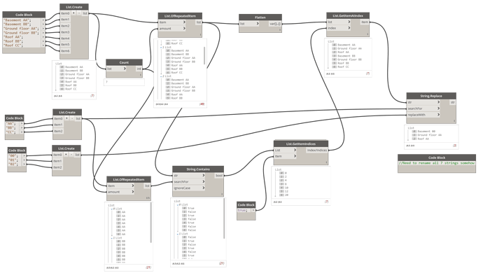

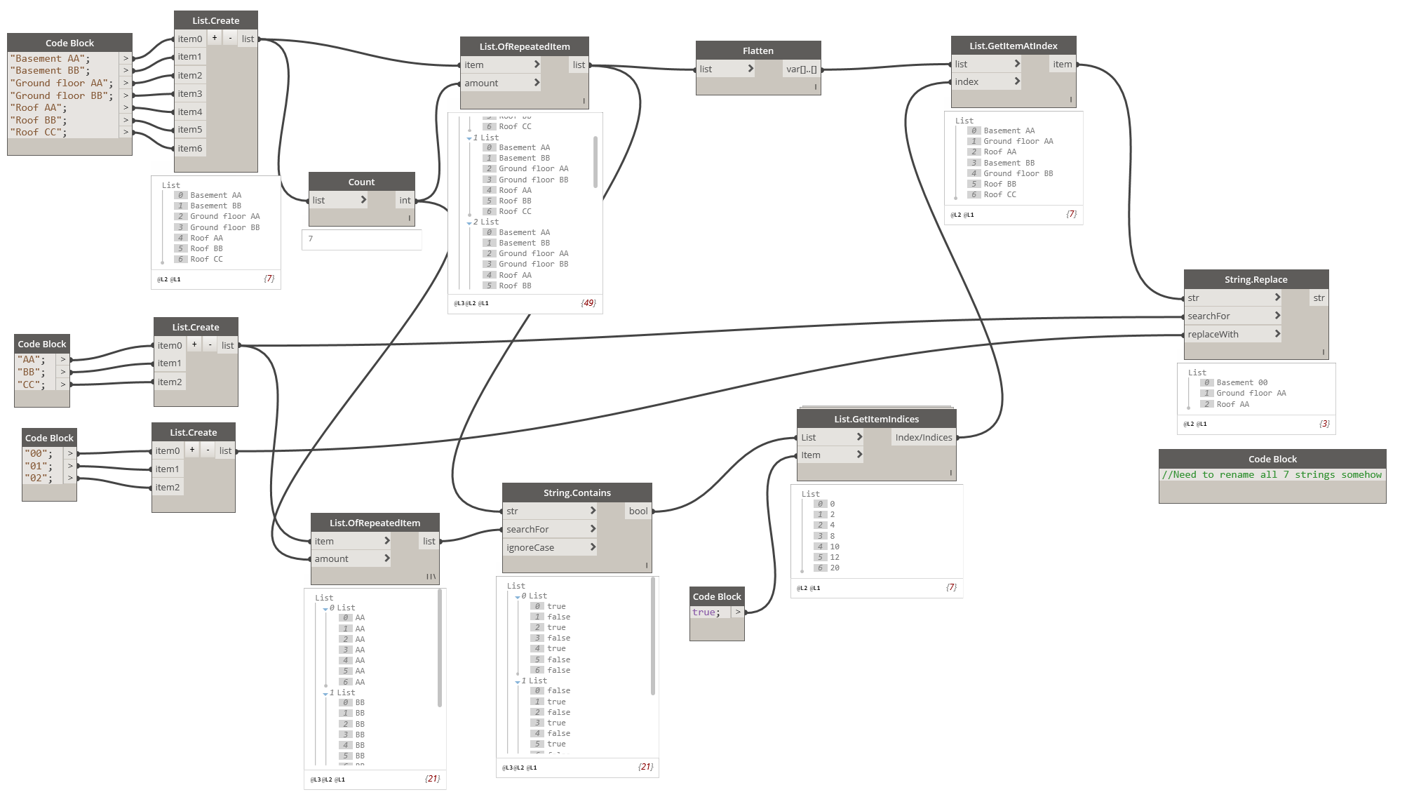

Another option:

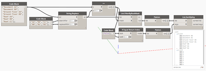

Edit - and if you need the same order:
Edit2 - not sure why it doesn’t return a single value, but I guess it could be nice to know which replacement value was used…

Thank you guys, these are all good solutions! Personally for now I prefer using nodes rather than all these codes, because it is easier to understand if something needs to be tweaked :slight_smile: thanks.
Hello Nick
the node If Equal return index from wich package is it?
It’s its own package.
