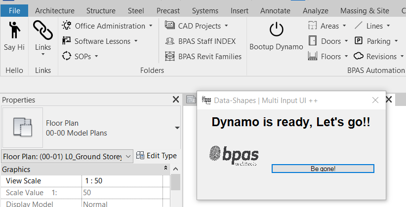

Great idea. Adding that. Thanks!
Used the data-shapes UI for consistency.
Thanks!
Noice one, and a nifty looking toolbar!
Ahh, thanks a lot!
