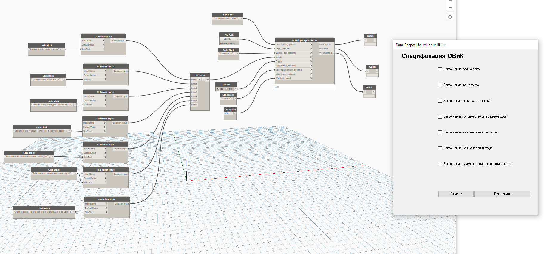

I use Data-Shapes to âstaggerâ the scripts and allow context-dependent inputs to pop up along the way. This might be what youâre after, or you can use passthrough nodes to make the script âwaitâ for other nodes to finish before executing.

I thought about data-shapes package, but i donât know which nodes i need to use for it ![]()

I tried to do it using data&shapes as suggested by @steinah6 , visually it turned out what I needed. But I donât know how to bind my blocks to these functions. I donât know how to link the script functionality to the visual display I got

P.S. But then what is the use of data & shapes nodes if you canât connect script logic to them?)
Itâs not a Data-Shapes issue. You can use Data-Shapes to control logic in your graph. Itâs just that the specific logic you want doesnât really exist. Again, we might be able to work something out if you shared the graph and what youâre wanting to do.
