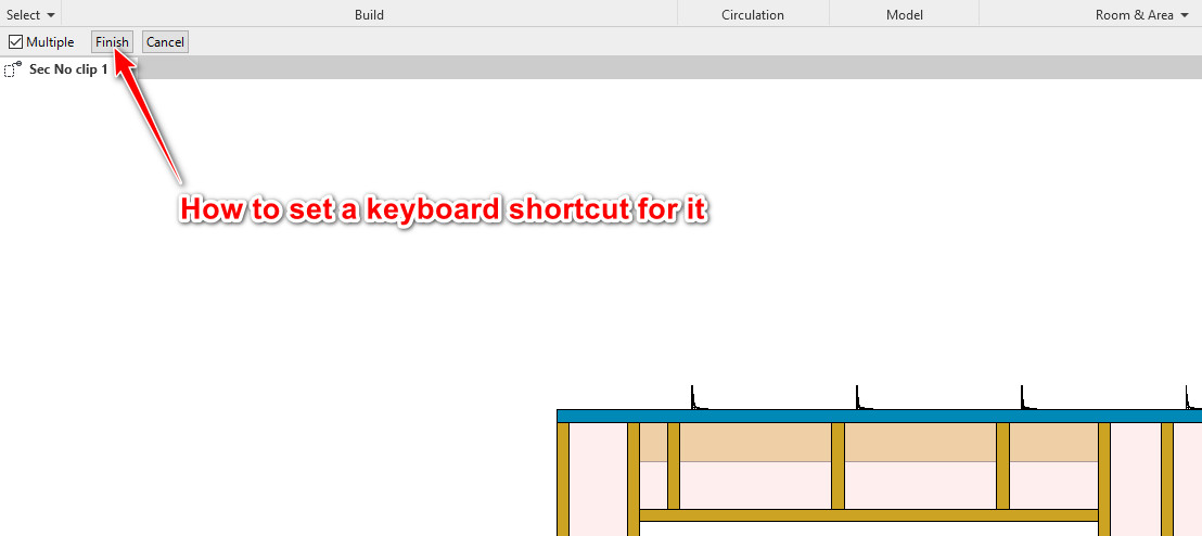

Is it possible to use another selection method?
I don’t want to delete constraints, I lose the workflow speed.
selecting elements with constraints Elements block the current Revit thread so the dynamo script does not launch until the objects are deselected
try using one of these nodes instead
They do not have right-to-left selection.
If I select Frame with Wall it works.
This is the one the API gives us unless you use a pick object method in a while loop like Cyril showed in the alternative.
