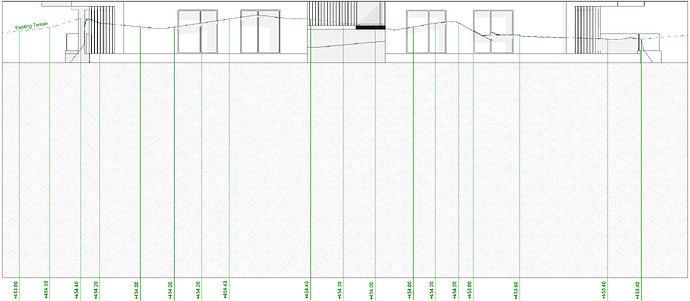

Hello everyone! I need to draw a line along the existing terrain profile, then I need to place spot elevations every 20 cm height as shown in the screenshot.
I have to repeat the process for several sections. Do you think could be there a faster way with dynamo rather than place them manually?

Hello @Almatt and welcome here…its best if you show your graph where you are stock…but try take a look here…Place Spot Elevation in SectionView and change Type
Good luck
Seems thre sometimes are some issues with clockwork in section…try Genius Loci instead…
