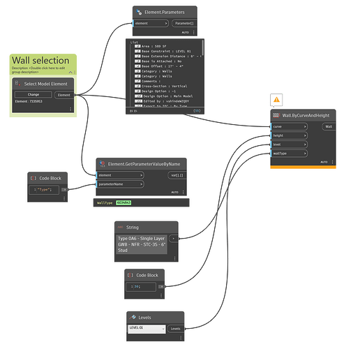

I have a wall with a height of approximately 49 feet. I want to split this wall at 30′, so that the bottom part remains as one wall and the upper remaining part (19′) becomes a separate new wall. Can this be done using my node?
Not with this node, but others.
  1. Get the current height of the wall you have.
  2. Set the height to the desired height.
  3. Create a new wall using the same location curve, wall type, and level as the original, with a height set to the previous height less the desired height.
  4. Set the base of the wall to the desired height.
complicates it a bit- but might be better to create a new level and host the new wall portion to that (with zero base offset)
