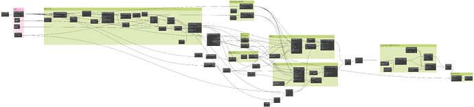

file dynamo revit 2024
Lap Splice Max Len 2024.dyn (161.2 KB)
