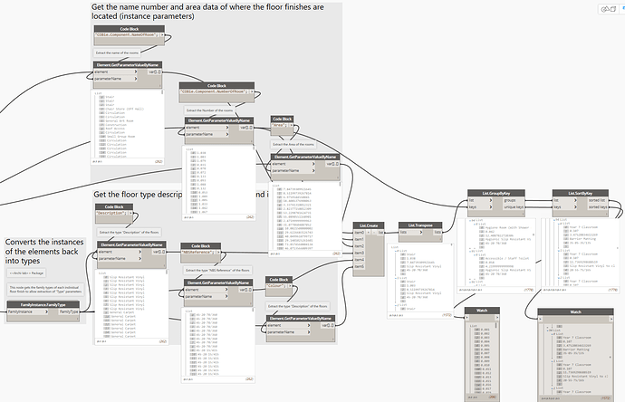

Hi All,
Is it possible to sort sub-lists without affecting the previous sorting of the list structure?
In the example below I have collected the floor finish elements and extracted the room name, room number (populated using RIE.Point.SpaceAndRoom Node) floor finish area, floor finish description, specification clause and floor finish colour. Some rooms have a single floor finish while some have multiple floor finishes.
After creating a list of the collected data and using List.Transpose I have each floor element with 6 values, I have then grouped and sorted the list by room number to give a list of rooms at level 3 and the floor finishes for the given room at level 2 which is the list format I would like to maintain.
What I would like to do now is sort the list at level 2 (floor finishes per room) by the floor area for the rooms with multiple floor finishes to give the primary (largest) floor finish at index 0 at level 1, secondary floor finish at index 1 at level 1 etc… All of my attempts thus far are rearranging the original list structure. Is this possible?
Any help would be much appreciated!
Dave R
I think sorting the areas of the finishes before grouping by rooms might do the trick
home.dyn (19.1 KB)
Another way by sorting after grouping by room : (might correspond a bit more to what you asked)
home2.dyn (18.9 KB)
Mellouze,
Thanks very much for your quick reply, your second suggestion done the trick perfectly. I wasn’t aware that you could use the ‘get item at index’ node in such a way as to sort the list by its given value.
I may be out of my depth for my next list management issue and might need to start a new thread but here goes… I would like to combine the list of floor finish elements which are grouped by room number @L3 and finish instances @L2 with a separate list of rooms elements by the matching room number to be able to set parameter values in the room category.
Having a look through some other posts on the forum, I believe I either need to use list combine or list create to collect the data together, then list map with a function in some form to format the list by the room number. I’m not too familiar with using list map to access sub-list so if anyone can point me to a similar post or in the right direction it would be much appreciated.
Match%20and%20combine%20floor%20elements%20with%20room%20elements|638x499
Dave R
