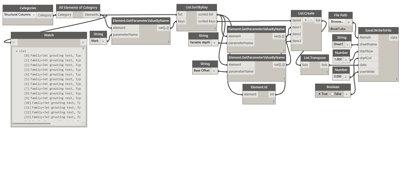

So I have created some columns in revit that are vertical and they supposed to be numbered 1,2,3,4,… In the same alignment I have also created slanted columns which are also supposed to be numbered 1,2,3,4,… Vertical columns were created in a correct sequence while slanted ones were created in a random fashion. I took this one alignment and copied it multiple times and modified the angles of the slanted columns. At this point the parameter name Mark is empty. So I went to dynamo and created a script to extract the parameter values sorting by IDs. When I change the values in excel and run a reverse script, I get the following:
- Vertical columns are numbered correctly (because they were created in correct order)
- The slanted columns are numbered wrong/randomly (column 1 becomes f.x. 22, column 22 f.x. 5 and so on)
My question is what can I do to make it work? Sort randomly created instances according to my selected sequence?
