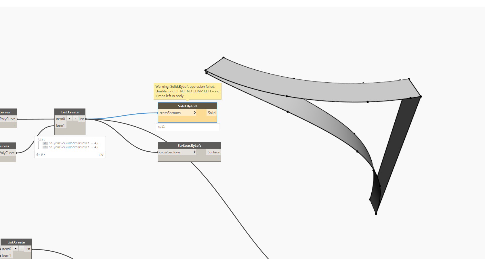

Please help with the below error.
Only reference to lumps with respect to Autodesk products right now is this.
Can you post your files?
Perhaps the acute point at the intersection is causing the problem…
You were right thank you
