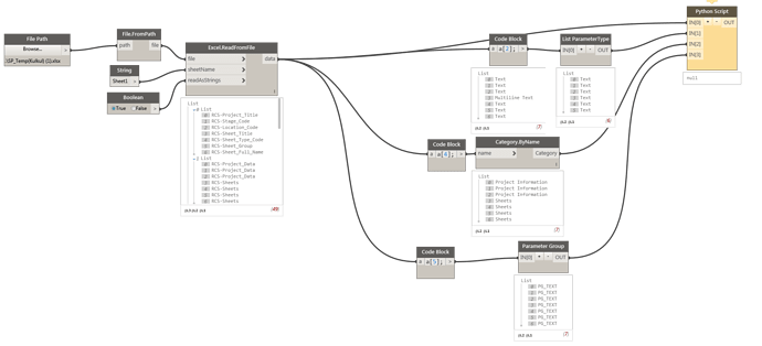

Shared Parameters with data managed from Excel List
Sincere Apologies - My Bad :sweat:
As the data in my head was transposed to the way this works along with the no headings, I was lost!
I was meaning the Type of Parameter
So changed it in the other row
Error is this now…
What am I missing or doing wrong?
Many Thanks once again @Kulkul
Sorry - Had missed to connect the first Input
Drops that value in the other list now…
Correct error is this
Change as shown in Excel file.
Thanks a lot @Kulkul - U Rock!! :clap: :clap:
