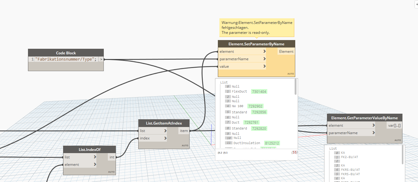

Shared Parameter is read only, why?
it is defnitly not read only… it is a string parameter addressed to all elements?
What make i wrong? what does Revit want ?

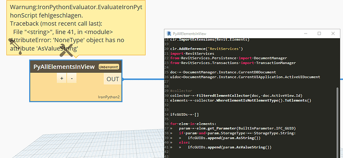

is this the best way ? to create a correlation between elements and values?
#collector
collector = FilteredElementCollector(doc, doc.ActiveView.Id)
elements = collector.WhereElementIsNotElementType().ToElements()
ifcGUIDs = []
for elem in elements:
	param = elem.get_Parameter(BuiltInParameter.IFC_GUID)
	if param and param.StorageType == StorageType.String:
		ifcGUIDs.append(param.AsString())
	else:
		ifcGUIDs.append(param)
OUT = elements, ifcGUIDs
I think you want the param.AsValueString() ?
I think you set it param.Set(value)
Is that what you’re after? :slight_smile:
@Mark.Ackerley
i checked out both, i got an error
AsString()
AsValueString()
When you OUT the param, does it correctly return a parameter?
i got Null and empty space @Mark.Ackerley
So if some elements don’t have the param they return null? You could add a try except? :slight_smile:
