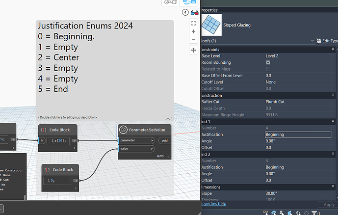

I am trying to set parameters in dynamo.
But my element has several parameters with the same name. But i want both of them to get different values.
As you can see “Justification” exist two time in my list, on number 22 and 23
But somehow i can’t change the value of number 22.
How can i get that parameter to change?
1 - unless one is an instance and the other is type, I suggest you rename the parameters.
2 - It’s a crappy solution and won’t necessarily work for every instance but you could just get item at index and use that parameter.
not sure but in your first image it should work as both justification parameter has value, but in your second image there are no value, dont know why it should always have a value i guess
