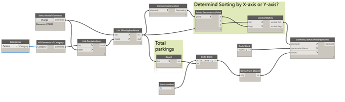

I do some parking renumber with dynamo by selecting elements, sorting by location, then renumbering.

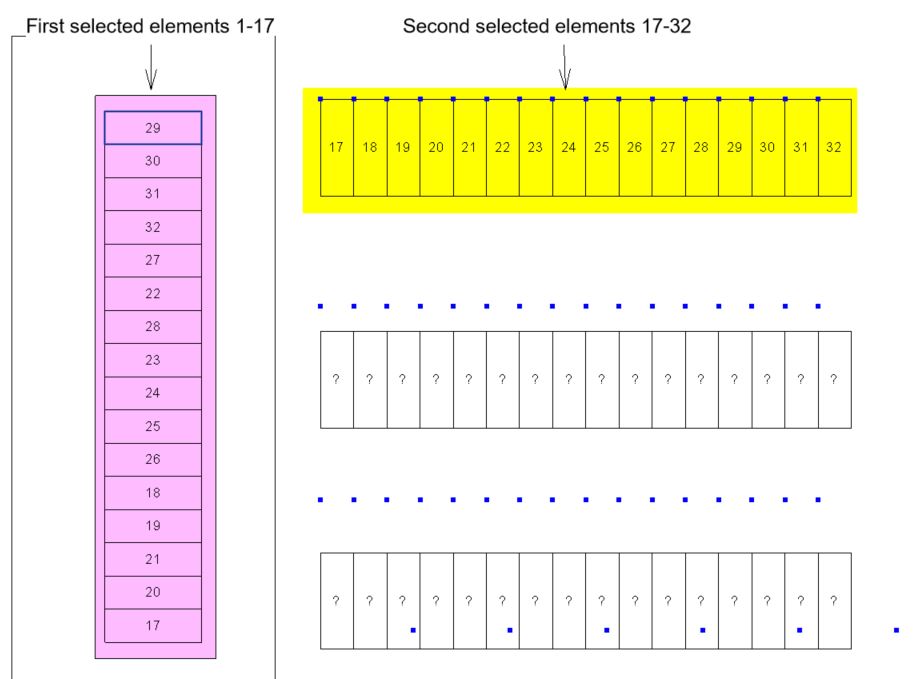

It worked well in dynamo. But when I select elements for another time, it changed parameter’s value not
only current selected elements but previous selected one. Here is my dynamo
Here is result in revit
That is a feature of Dynamo. When you run a script, the changes aren’t saved until you close the script/Dynamo. So if you run the script once, then change inputs and run it again, anything that was produced in the first run will be reverted back to original. This is intentional as it allows you to test your script without having to constantly undo the changes before each run.
The easy work around is to just close the script and open it again between successful runs.
