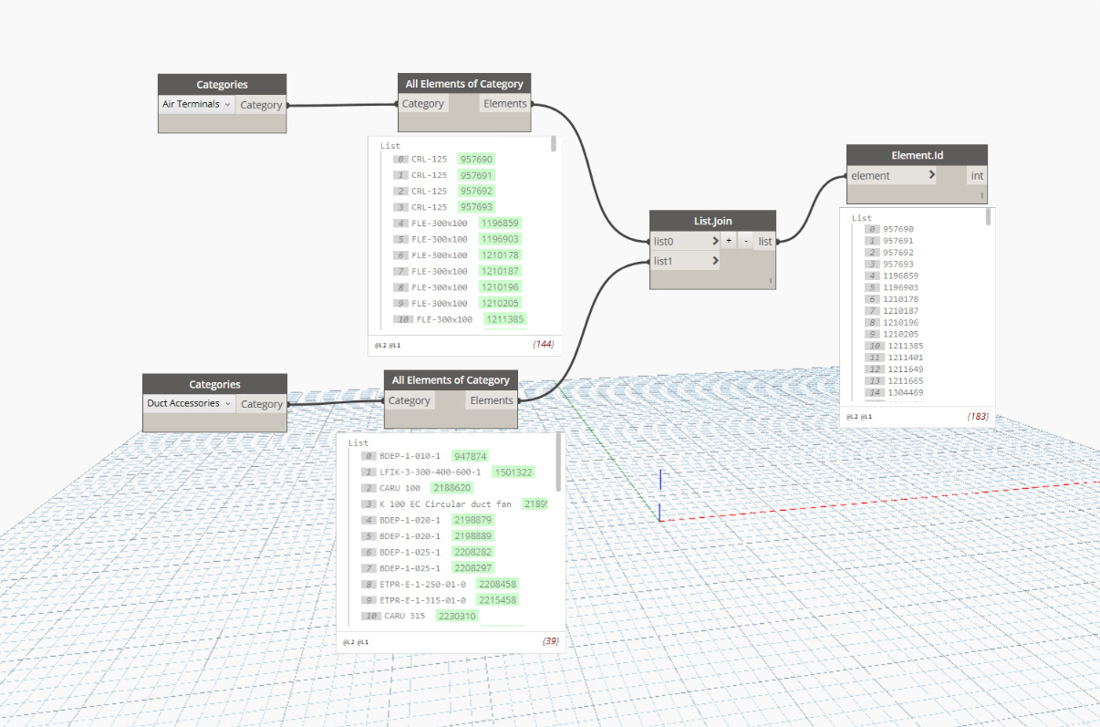

Is there a node that creates successive lists of ID elements from the air terminal to the fan.
the quality of the whistles should correspond to the number of air terminals.
In each list, the succession of elements is formed by the movement of air from the air terminal to the fan.
is this what You are looking for?

Получение списка участков систем вентиляции.dyn (9.1 KB)

I would approach this differently. First for every duct or fitting get the ID of the (2 or 3) connected elements and write this into parameters in each duct or fitting. (ID in, ID out, ID Branch)
Then, get all the ducts and fittings per system and use the parameters to sort into the correct order.
- It is necessary to build the number of entries equal to the number of air termals in the system.
- In the list, the sequence from the air terminal is built up to the end of the network (fan). Ie at first the elements of the branch, then the main elements and ducts without branches.
- Yes in the lists will be the repetition of the elements.
- e.g. each list generates a sequence of elements by the movement of air from / to the air terminal to the fan.
