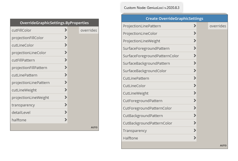

Sorry about that…please try with below Create OverrideGraphicSettings….

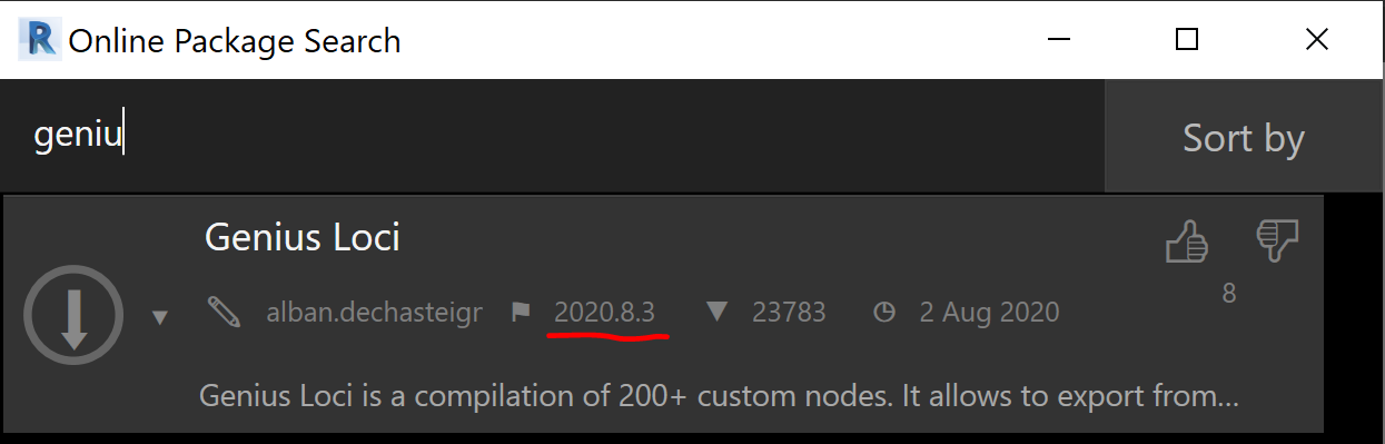

i have already tried with this package but these node not available in my system.
You need to update the Genius Loci package, your version is almost one year old :
