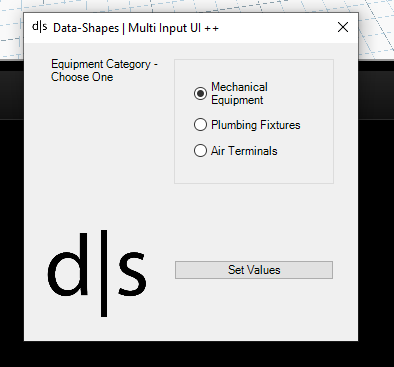

Working through a similar workflow today, this may help get you started:
RadioButtons -> Choose 1 from a given list.
Listview -> Choose as many as you want from a given list.
In your case, you’d actually want to reverse the steps: Give a Listview of the Viewtypes, then provide a RadioButton of the Views in that type.
