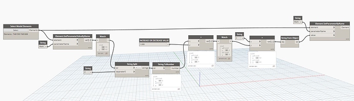

Hi All,
I am trying to do something similar to this script. I have hundreds of columns in my graphical column schedule, each with its own column tag (C1, C2, C3 etc.) sometimes i need to put a new column in between theses tags, So column C2 needs to be now C3, C3 needs to be C4 etc. Each column uses the parameter ‘Mark’ i would love to be able to select certain columns and bump the ‘Mark’ value by a specific amount.
Any idea how i can go about this? all help would be greatly appreciated.
Thank you in advance.
Shane.

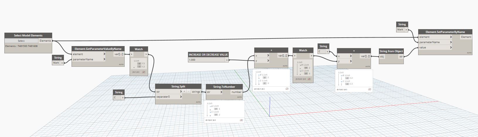

Hi All,
I have answered my own question! see attached image the graph. Any comments to streamline would be appreciated.
Cheers,
Shane
