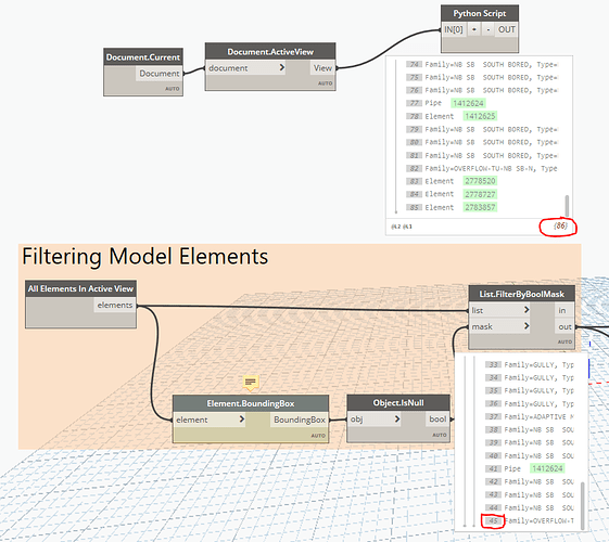

I need to select only model elements in the active view, but “all elements in active view” gives unwanted things like system types also.
This is the way i’m filtering out the unwanted currently but it seems to be very slow process.
Can anyone provide me with a better solution?

Hi Amol,
Thanks for the prompt reply.
As you can see in the image that the code is still giving the “piping systems”, which aren’t model elements.

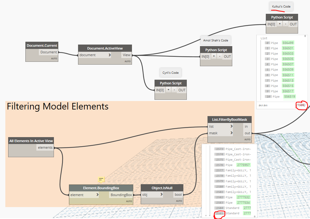

But for a fact I know the view has 46 elements only, though your code is returning 86.
“Element” elements from the code cannot be selected.

Hi Kulkul,
I cannot send the specific file as it is from an ongoing project but you can see I just tried it with a test file and the outcome is same. And this should work for all types of element, irrespective of being from mep/str.

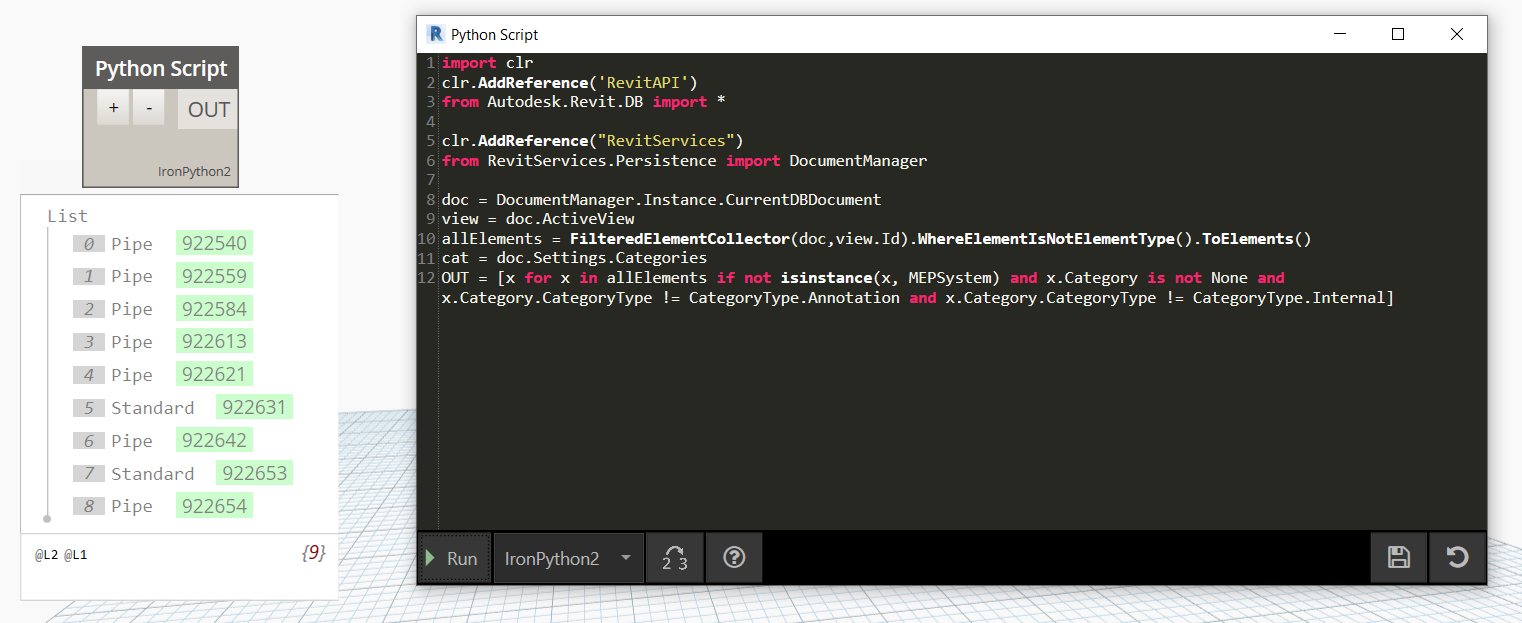

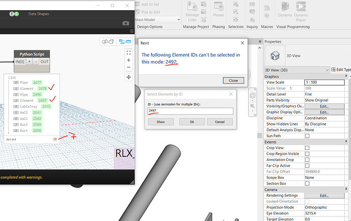

I think we are close but still these two “element” elements are something which are not visible/ cannot be selected.
total elements should have been 7, but are 9 because of these notorious “element”.
I think they are somewhat related to pipes.
here’s the test file i’m using.
Because those are Center lines of MEP Elements. Change the last line to this:
OUT = [x for x in allElements if not isinstance(x, MEPSystem) and x.Category is not None and x.Category.CategoryType == CategoryType.Model and not x.Category.Name.Contains("Line")]

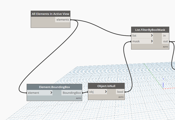

If you’re trying to get elements which has bbx then you can do the same using API. There are many examples on this forum, you can use forum search. Currently, I am not near my pc.

FYI, bounding box method is also quick. But if you still want to go with python. I will post another method in about 9 hours from now.

Do you have any idea what is this?
(sorry for dragging it)
Was using in live working model.
Thanks,
No! You can check by typing that ID in Revit.
