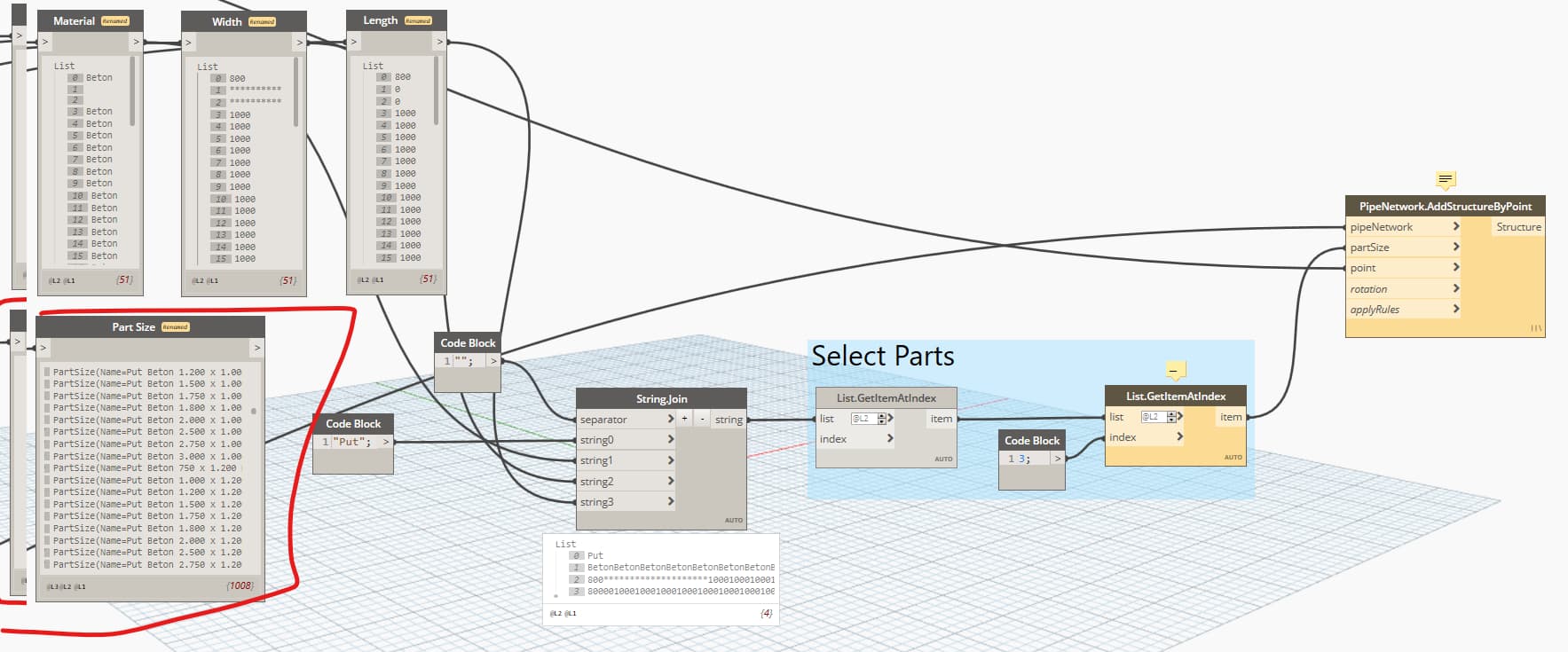

I am struggling with the following problem. I have a list of 50 points, which have the attributes Material, Width and Length. I want to make a structure based on a parts list. This list consists of structures with a specific Material, Width and Length. See
Unfortunately this returns a list with 4 items all joined together (probably to be expected from String.Join)
Any ideas on how to get this working properly?

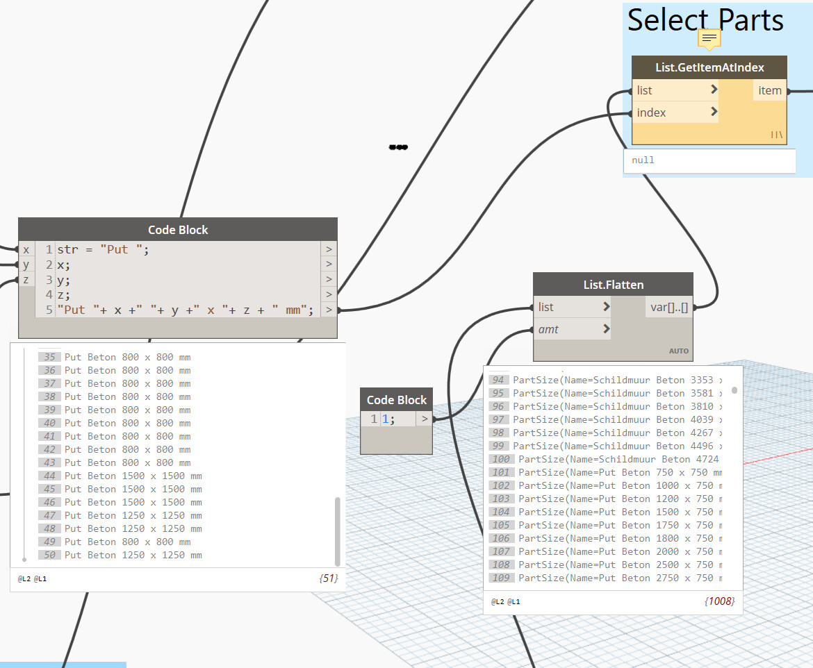

I was able to fix it with String from Object. The replace is now working correctly. However, i am stuck at the next step. List.GetItemAtIndex is not working because the joined part is not an index. GetItemByName doesn’t work either because the Partslist is not a ListDefinition.
Any idea?
Please if it is possible attach an image of your problem it will help a lot.
I tried both of the following things:
Maybe you need a get all indices of node, not get item at index?
Hi @Nindooo in your first image it looks like you need an “element name” before feed in "index of…
Try to check if it same object type and names match…
Thank you very much, this worked!
