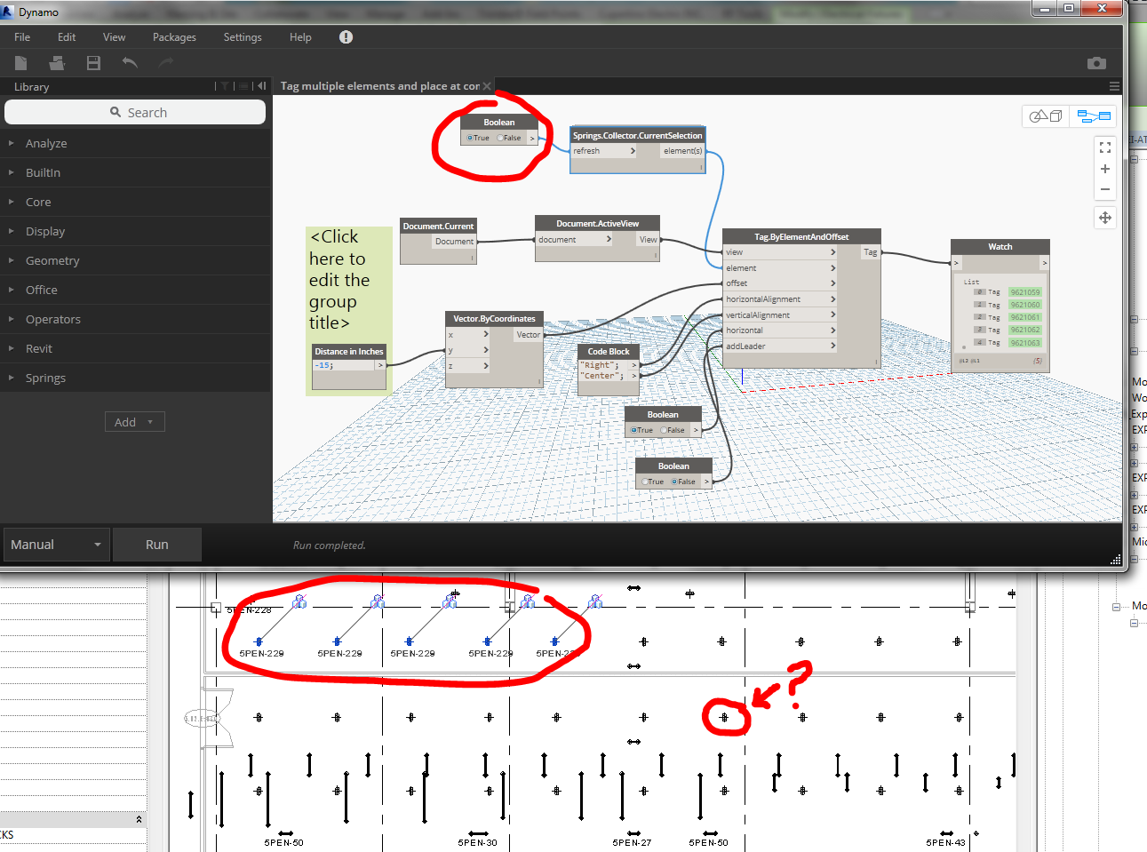

Hi, I have a script that from the outside appears to be working, however after I run it the first time to place my tags, and then toggle the boolean switch to initiate a new iteration, and then press run again, it still places the tags on the new items, however, it keeps deleting the previously placed tags. What gives? why is it doing that? and how do I make it stop? thanks

This is because dynamo is built to allow for each “run” to replace created elements with each successive run - this is ideal for most uses as you wouldn’t want 70000 different geometry instances created as you tweak a graph to check stair headroom as one instance.
There are several solutions noted in the forums, including:
  1. Use python scripts with additional code to remove the link between dynamo and the created elements.
  2. Close the dynamo graph between runs.
  3. Execute the scripts via dynamo player.
#3 is my personal preference.

Ok, so…where we left off on this topic I said that dynamo was deleting previously tagged elements tags even though I was toggling the refresh button ont he springs.collector.currentselection node each time I hit run. And @jacob.small said that it had to do that, however, when I use the same node to do different functions, it does not delete the previous functions, for example, when I copy two parameter values to an entire run of conduit, I can just go from conduit run to conduit run, selecting the new source elements for my parameter values, toggle the refresh button, select the new conduit run, and press run, and vwolla, no problems. But when I do it with tags there is a problem. I have to close dynamo everytime, and sometimes that doesnt even work. What is going on? Thanks
Changing parameter values doesn’t create new element Ids so there isn’t anything to delete. :wink:
