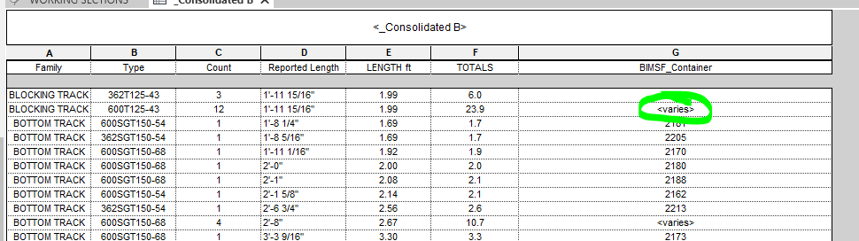

Schedules with varies
Is there a script that lists out the “varies” outputs within the same row? Hoping for something easy where I dont have to sort or create / combine my own lists.
What do you mean?
You could certainly write a script to output all the unique values, but if you mean to actually change the value in the schedule, then no. The values are per element, so you can’t just list multiple values in a single cell.
I think you basically answered my question. Trying to think of another way around this…maybe I could create a new text parameter for these elements and have a script that fills this out for me.
That is an option, yes. It would just be a manual update process since that data would not be “live”. It may also be possible to just add another level of grouping to show all unique values.
