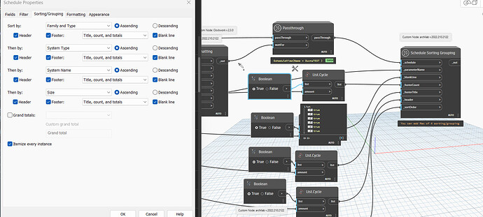

Similar question - How do I sort by multiple Fields? I want to sort by Family then a Length.
Edit: By using nodes. I can get it to work with just one field only.
Hi guess you will need cycle your input so it match your fields count
maybe
Thanks for the quick response, it looks like you were able to do it. I am a little new to the cycle node…first time using. Can you take a look at what I got? I am unsure about the amount I tried a few value.
edit - i cycled the sort order too , i think i missed that. still having issues.
all input should cycle as so many fields…here with 6 fields…however doesnt really matter as revit only accept 4…
Awesome I was able to figure it out! I ended up not needing the passthrough, but cycled everything per the number of fields i needed to sort by. I ended up needing 3 sorting options. Worked like a charm saved my team a lot of hours cause we had like 1000 schedules to fix.
