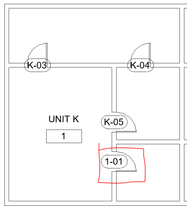

Hi NIck
In list transpose node i get the unit group door informations but please help me how to match below group door information to above group door information is their any node to match with above node please help me on these it was very helpful for my project
You would have to split your lists and compare them against each other.
Thank you for your information
As par your instructions i split into two categories, but how to campare each other is their any node to match with each other
please help me on thisYes, there are multiple nodes/ways to compare items in a list. Do a little research in the forums first, I’m sure you’ll find something to point you in the right direction.
