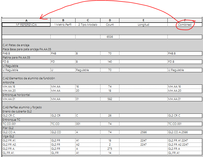

Hi, does anyone know if we can read the values of a schedule column (data combined from Revit) from one planning table, to write it in another column?.

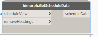

Hi @Jordivdl
There is a custom node from bimorph package called “GetScheduleData” that will read schedules.
