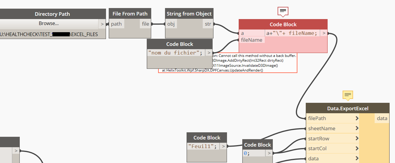

Is it possible to save an excel file in a specific name and location ?
I have always used the “DataExport.Excel” but if I’m not wrong this node needs a pre-registered excel file.
Regards,
You just need to provide a file path. The file does not need to already exist. The Data.ExportExcel node will create the Excel file if it does not exist.
Thank you @Alban_de_Chasteigner,
So I was wrong, we can specify the filepath.
Is there any way to select the nom of the file each time I run the script?

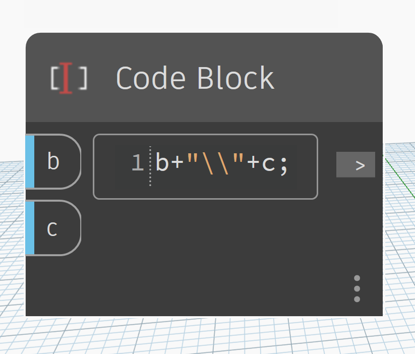

Try with "\\"instead.
