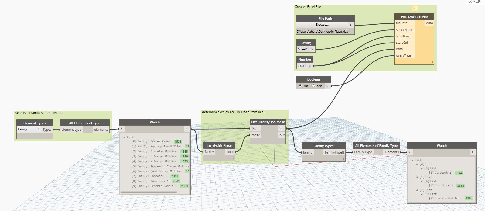

I have an odd situation. I created a Dynamo graph which finds all of the “in-place” families in a project and then exports them to an excel file.
When i created this, it worked fine, no issues at all.
I opened it up this week to use it again, and now it doesnt work. It will find all of the in place items, but it wont create the excel file. It says, “Warning: Excel.WriteToFile operation failed”
I have not updated Dynamo, no updates to any of the packages. As far as i know, nothing at all has changed on my PC, but it doesnt work.
Has anyone seen this before?

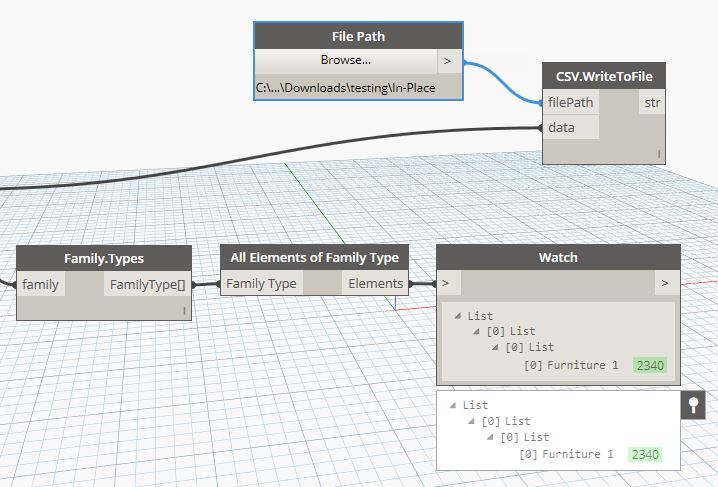

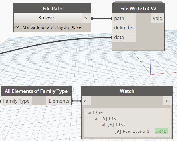

Thanks for the advice. I did try the csv file route, but still non dice. I trieds two differnet csv exports and both delivered odd results.
- CSV.WriteToFile created a file called In-Place but did not give it a file extension. Once yo manually add the .csv extension, the data is correct, but should it npot create a .csv file to begin with?
- File.WriteToCSV Created a file called In-Place.csv but the information is wrong. in cell A1 it has the work IN and that’s it.

Post your last attempted graph as a screenshot and the actual dyn file as well and I’ll try and have a look later. Attempt both the CSV and the xls in it if you can.
IN-PLACE FAMILIES-CSV 1 OUT.dyn (7.3 KB)
IN-PLACE FAMILIES-CSV 2 OUT.dyn (6.9 KB)
IN-PLACE FAMILIES-EXCEL OUT.dyn (9.5 KB)
Current graph’s that i cant get to work.
