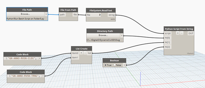

I am trying to run a batch process for a set of Drawing files in a folder, trying to turn CAD Layers ON/OFF in Civil 3D. Somehow the script is failing. I am using a couple of references similar to this one below:
https://forum.dynamobim.com/t/changing-the-visibility-of-layers-in-a-viewport-vp-freeze/74979
The Python Code below, I used a couple of sourced references as below, but its failing in the function
i = t.GetObject(lt[layer], OpenMode.ForWrite)
where I try to get the Layer Object. The layers are fed as layerNames Strings, as seen in the Dynamo Graph

Please suggest the way forward and the issue.
