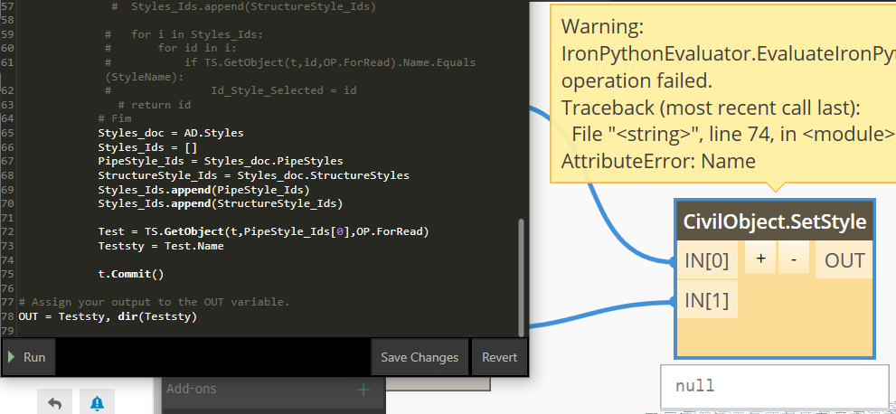

AttributeError using Python Script
I’m trying to get the style name but even though it appears as an option in dir(), I can’t use it.
Does anyone know if I’m forgetting something or doing something wrong?
Try
Out = test,dir(test.Name)
Or
Test= …
Teststy = test.Name
Same thing.
And… same thing :confused:

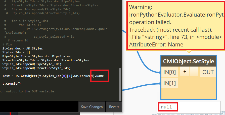

2 picture
Delete. .Name from line 72
Just like the “Test”
Please Every time
you attach the code Not a picture of him
So that I can experiment to find the best solution If it is simple, for example, change faster
Line 73 Test.Name
Line 77 out= Teststy

I just understand what’s happening, I read in the API that the “.Name” method is not to get, but to set.
The problem was that Python did not accept two operations on the same line So must be divided to two lines
with adoc.LockDocument():
    with adoc.Database as db:
        with db.TransactionManager.StartTransaction() as t:
            # E vem ai:
            Styles_doc = AD.Styles
            Styles_Ids = []
            PipeStyle_Ids = Styles_doc.PipeStyles
            StructureStyle_Ids = Styles_doc.StructureStyles
            Styles_Ids.append(PipeStyle_Ids)
            Styles_Ids.append(StructureStyle_Ids)
            Test = TS.GetObject(t,PipeStyle_Ids[0],OP.ForRead)
            Teststy = Test.Name
            t.Commit()
OUT = Teststy
As I said, the API says that this “.Name” in this type of object only serves to set the value and not get.
So I had to think of another way, arriving at this solution:
IN[1] is the string of the name of the style you are looking for.
And the output of the function is the style Id.
