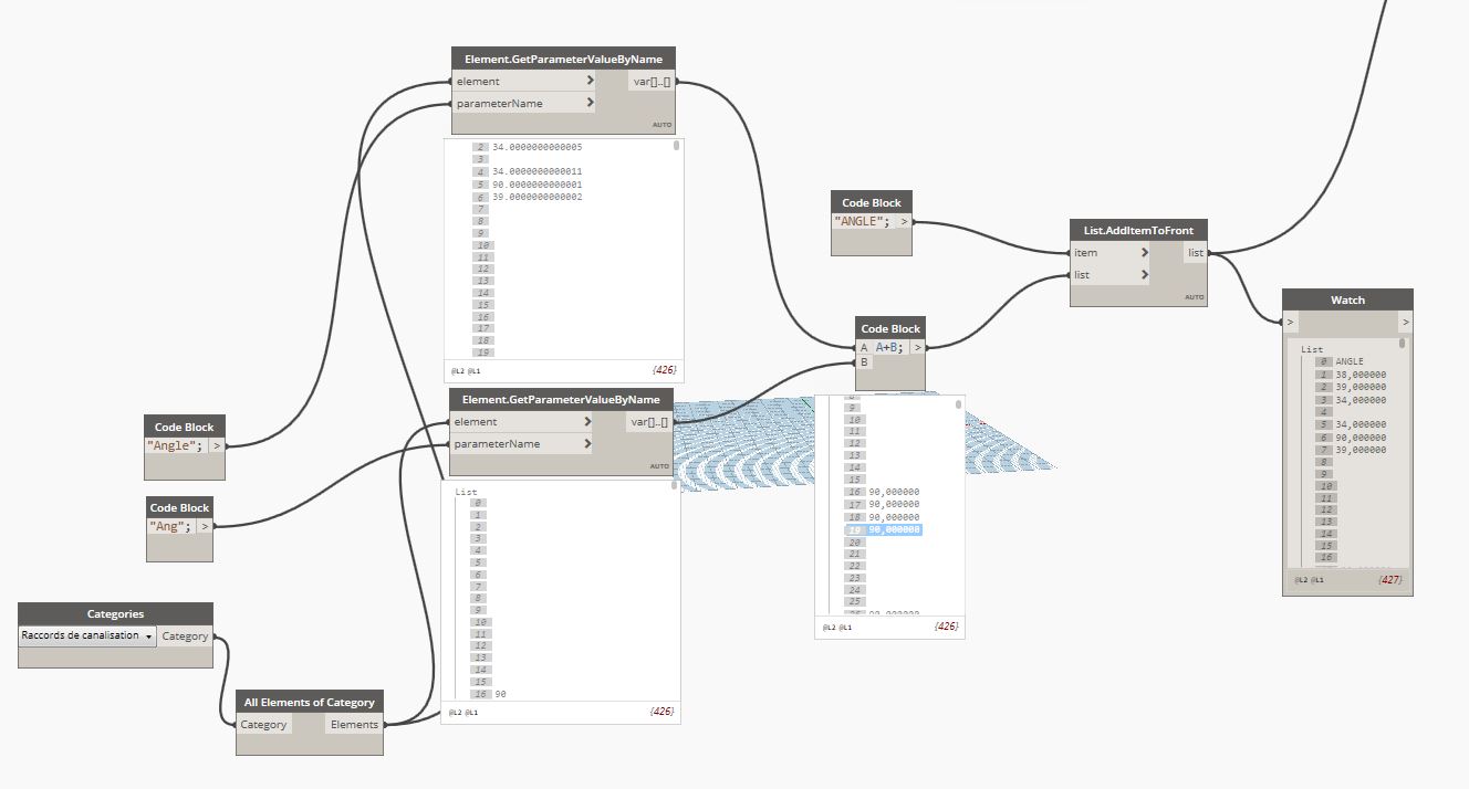

This script work fine only thing is rounding. Probably I’m doing something wrong from begining because anywhere I palce Math.round the script doesnt work! !
This is the script:
and this is out come:
and expected outcome!

The image you posted of your graph isn’t legible. Try using the export workspace as image button (#6 in the second screenshot here) after zooming in so you can easily read the node names and previews.

Can you wire an ‘Object.Type’ node in after the a+b code block, and expand the preview for it and the a+b code block?
Math.Round isn’t helping as your values are text, not numbers at this point. My guess is that the ‘ang’ parameter is text ;the other values have a floating point so more likely doubles). So let’s clean up some strings.
Add a String.Split node after the a+b code block. Use a “,” as your delimiter. Then use a List.FirstItem node with longest lacing to pull out the first value from each sublist. Wire that into the List.AddItemToFront and you should be all set.

I thing I dont get it. I dont understand “with longest lacing”.
Second thing. “Ang” and “Angle” they are both numbers (in Revit they signify angles)
If its text then I should convert text to numbers.
Lacing is how Dynamo deals with replication. Check the Dynamo Primer for more info, but basically every node you have is set to ‘Auto’ lacing. You need to get the first item from each sublist, so by using longest lacing you accomplish that. Right click the node, in the lacing option choose ‘longest’.

Great it works and thanks for the explanation!
